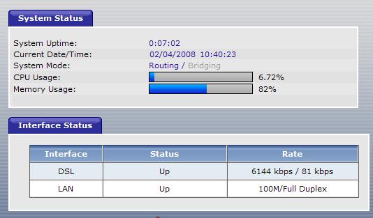

Знаю на форуме куча тем с похожей и даже однотипной тематикой но спрошу в 100 раз.
Какие есть варианты по увеличению Исходящей скорости, т.к сейчас такие показатели 6144 kbps / 48 kbps особенно расстраивает исходящая скорость.
Настроен сейчас так:
Модем Zyxel P660RT2
Настроен Роутером
Сижу на Annex A
Multiplexing - LLC
Encapsulation - PPPoE
Modulation - ADSL2+
Вот кстати если качать (не завист откуда) скорость скачки не превышает 210 кб\с про исходящюю вообще молчу Sad

Вот параметры ATM
Код:
[ SAR Counters ]
inPkts        = 0x0001bbd0, inDiscards    = 0x00000169
inF4Pkts      = 0x00000000, inF5Pkts      = 0x00000000
inDMATaskEnd  = 0x00000000, inBufErr      = 0x00000000
inCrcErr      = 0x00000092
inBufOverflow = 0x00000013, inBufMaxLenErr= 0x00000000
inBufLenErr   = 0x000000c4, inBufDescrOV  = 0x00000000
outPkts       = 0x0000e79d, outDiscards   = 0x0000427d
outF4Pkts     = 0x00000000, outF5Pkts     = 0x00000000
softRstCnt    = 0x00000000
Вот параметры DSL
Код:
noise margin upstream: 9 db
output power downstream: 12 db
attenuation upstream: 24 db
tone   0- 31: 00 00 00 00 00 22 22 22 22 00 20 32 22 32 33 23
tone  32- 63: 00 00 00 00 00 00 00 00 00 00 00 00 00 00 00 00
tone  64- 95: 00 00 00 00 00 00 00 00 00 00 00 00 00 00 00 00
tone  96-127: 00 00 00 00 00 00 00 00 00 00 00 00 00 00 00 00
tone 128-159: 00 00 00 00 00 00 00 00 00 00 00 00 00 00 00 00
tone 160-191: 00 00 00 00 00 00 00 00 00 00 00 00 00 00 00 00
tone 192-223: 00 00 00 00 00 00 00 00 00 00 00 00 00 00 00 00
tone 224-255: 00 00 00 00 00 00 00 00 00 00 00 00 00 00 00 00
tone 256-287: 00 00 00 00 00 00 00 00 00 00 00 00 00 00 00 00
tone 288-319: 00 00 00 00 00 00 00 00 00 00 00 00 00 00 00 00
tone 320-351: 00 00 00 00 00 00 00 00 00 00 00 00 00 00 00 00
tone 352-383: 00 00 00 00 00 00 00 00 00 00 00 00 00 00 00 00
tone 384-415: 00 00 00 00 00 00 00 00 00 00 00 00 00 00 00 00
tone 416-447: 00 00 00 00 00 00 00 00 00 00 00 00 00 00 00 00
tone 448-479: 00 00 00 00 00 00 00 00 00 00 00 00 00 00 00 00
tone 480-511: 00 00 00 00 00 00 00 00 00 00 00 00 00 00 00 00
noise margin downstream: 5 db
output power upstream: 10 db
attenuation downstream: 37 db
tone   0- 31: 00 00 00 00 00 00 00 00 00 00 00 00 00 00 00 00
tone  32- 63: 00 00 00 11 21 33 33 43 44 44 44 44 44 44 44 33
tone  64- 95: 44 55 55 55 55 66 66 77 77 88 88 88 88 88 88 98
tone  96-127: 88 88 78 56 67 77 77 77 77 77 88 07 88 78 77 77
tone 128-159: 77 67 35 52 77 87 88 88 88 88 88 89 78 76 88 88
tone 160-191: 88 78 78 66 66 87 88 88 78 88 88 88 88 88 88 78
tone 192-223: 76 88 77 77 77 77 57 76 77 66 76 66 55 24 23 22
tone 224-255: 11 32 44 44 34 55 55 44 53 45 45 14 53 65 45 33
tone 256-287: 24 44 13 32 33 23 11 12 01 00 00 00 00 00 00 11
tone 288-319: 11 20 33 32 12 33 44 34 41 55 55 24 33 44 44 32
tone 320-351: 44 44 24 33 33 23 22 22 22 22 11 11 00 00 00 00
tone 352-383: 00 21 43 44 23 44 44 33 32 44 33 44 33 42 44 42
tone 384-415: 32 44 34 43 33 33 42 33 23 33 33 23 32 23 23 32
tone 416-447: 33 33 33 23 32 33 12 22 22 11 21 21 12 11 11 01
tone 448-479: 11 11 00 00 01 00 00 00 00 00 00 00 00 00 00 00
Мне воопще ниочем не говорят эти нули и цыфры, отправил письмо на help.es-nso.ru жду ответа ))

ZeXoR
шляпа с линией у тебя. Так что входящих 6Mbps - предел мечтаний. Параметр noise margin downstream нужно вытянуть хотя бы до 10. Смотреть нужно проводку (прежде всего в квартире) и по необходимости заменить.
Причем входящая тепереь тоже упала с 6 мб\с до 2 мб\с (тоже после разговора) странно все это!
с разговором это вряд ли связано. Из-за плохого сигнала модем понизил скорость.
